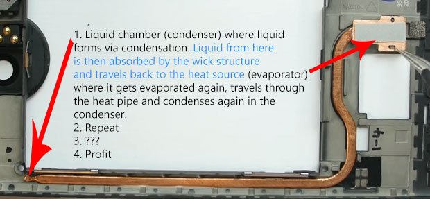

The phone has a heat pipe, which is nothing new in the PC space. Laptops and most CPU desktop heatsink solutions.
Heat pipes contains a gas in them which turns into liquid based on temperature to help conduct heat. Some manufactures of heatsinks like to calls this with a marketing name of sorts.
What is new (and I guess ground breaking), is that you have a phone with a cooling solution for a hot processor. No other phones has this, and that solves the overheating issue under normal phone usage of the Snapdragon 810 chip, a bit problem with other phones with this chip, making your experience with the device fluctuate from smooth to choppy due that the chip overheats and throttles. This does not happen with the Lumia 950 XL, we all enjoy a consistent performance.

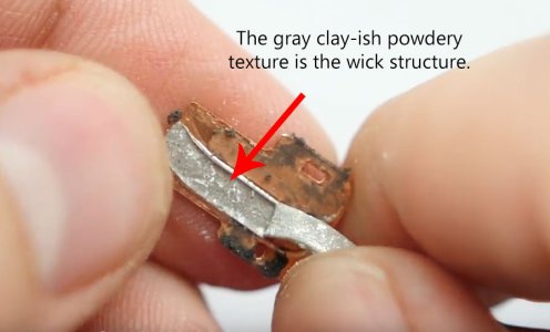

When this guy opens the pipe, some powder appears. Is it safe to assume that this "powder" changes from this powdery form, to liquid, to gas, and back to powder again depending on the temperature or pressure?

no
Elaborating on your answer would be greatly appreciated
There is no known substance (on earth) that can change from solid (powder), to liquid and then to gas within a temperature range of just 60 degrees Celsius (or Kelvin) - that from normal room temperature (25C) to the normal maximum temperature of mobile processors (85C) at normal pressure values. Phase changes require higher temperature differences (at constant pressure) and higher pressure differences (at constant temperature).

it's not real liquid cooling. It's a real vapor chamber though. And there's this paste and locked in vapor in it that helps with the cooling.

Microsoft talked about a liquid cooling during the presentation. Several teardowns actually showed that the smartphone is equipped with a real heat pipe. We checked if there is a positive effect on the performance under sustained load with the GFXBench Battery test, which repeats the T-Rex test 30 times and logs the frame rate as well as the battery charge. It turns out that Microsoft is the only manufacturer that can handle the Snapdragon 810. The Lumia 950 XL also loses some performance, but the drop is comparatively small at 14.5%. Other smartphones with the same SoC suffer from bigger performance drops, it does not matter if you look at the LG Flex 2 (-16.2%), OnePlus 2 (-33%), Sony Xperia Z5 (-29%), Nexus 6P (-31%) or HTC One M9 (-38%).
The "real" heat pipe essentially is a vapor chamber. No other phone has one.

A lot of people think it's 'liquidless' just because it doesn't have anything in it, when the fact is that the heat pipe has a wick structure which holds the liquid. This gives it the clay-like texture seen in the video.
Now that you know there's a wick structure in the heat pipe, here's an overview.
