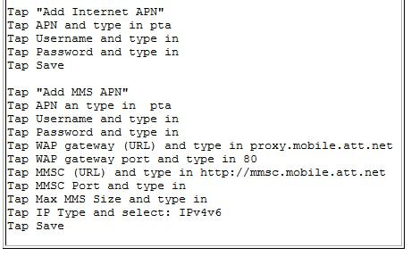

Try these settings:

Try these settings:
Interesting results. Setting the APN to PTA knocked me down to 4G. Setting it to phone keeps me on LTE but too soon to know if will help with my issue. Nice to know this little trick. This could have also been a good thing to test when I was having trouble. If PTA works better overall I might just leave it there, we'll have to see I guess.

Try these settings:
A quick update: Since changing the APN from nxtgenphone to phone, I've seen my connection drop down to 4G and even E on a couple of occasions when LTE is weak or non-existent. So I think this APN is working better, at least more like I would expect. Thanks again for the help.
