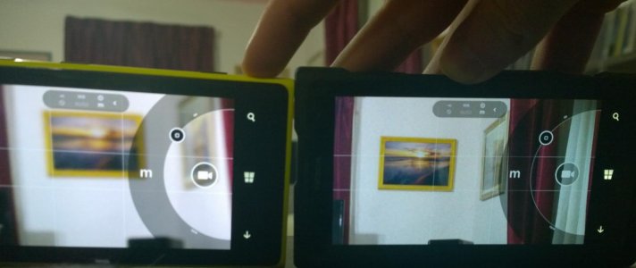

I just freshly restored both the eBay purchased 1020 and one of my own 1020s using the windows phone recovery tool. This should put them both on exactly equal grounds software wise, right? I can't be bothered to try restoring the eBay one down using the internal Nokia recovery software, to an even lower firmware than the current one to entirely rule out software issues with the latest version. (neither of my 1020s have this issue, and the one I just restored was running older software when I first tested against the eBay one, and then was updated normally, and then restored clean).
This is an example of the issue.
The one on the right is the one I own, and worked fine before and after the fresh restore. The one on the left is the eBay purchased one. Yes, the one on the left is slightly out of focus in the actual picture of it because it is hard to keep 3 phones steady at one time. However, it very accurately shows the problem I'm having. Even with the focus slider set to pretty much exactly the same point on both phones, the one on the left does not focus clearly. (Even with the slightly blurry picture generally, it looks like that in person). It is as if the focus ring only controls image focus within 4 feet.
Still weird is the tap to focus *does* work, which I would have thought uses the autofocus hardware. Maybe not, and it uses software algorithms to focus when you tap to focus, but uses the autofocus for sensing the manual focus slider and just general autofocus in videos?
Anyway, just an update with an image of the issue in case that sheds light on it even further.

It is a hardware issue, I tried pretty much everything software wise I could think of short of restoring it to an older firmware/OS via the internal recovery tool from Nokia, which I shouldn't have to do anyway as both of my other devices are fine on their firmwares/updates. A new phone was bought, the original returned, and all is well with the new one. No issues whatsoever. Now, there may have been some combination of something I didn't try where the focus could be forced into working perhaps, but I shouldn't have to. The focus should work without screwing with the software to try and get it barely usable. (if you are on a beta, sure, that is fair play if it doesn't work properly, but it wasn't)

That may be, but this is not the case here. The original post details everything out more so. Side by side comparisons between two other lumia 1020s, and it the one with the focus issue didn't do what it should do if it was working properly. Like I said, I did pretty much everything software wise to try and get it working. I even flashed one of my phones to the exact same setup firmware/OS/App wise as broken one, and mine still worked fine.
Even the focus ring didn't work properly, it only focused within about 4 feet.
Originally I was posting and asking if anyone else has had similar issues before, hoping it may be a rare software issue. (I wasn't too high hoped there though). More testing though, and I'm 99% certain it was a hardware defect. (only reserving 1% for the use of internal testing tools and such, which I shouldn't have to use)
