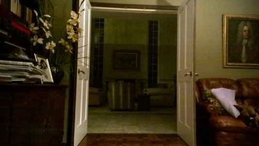

Here's a few pics I took with my 1520 last night at a pub:
WP_20140124_20_09_23_Pro.jpg WP_20140124_20_09_33_Pro.jpg WP_20140124_20_10_03_Pro.jpg
