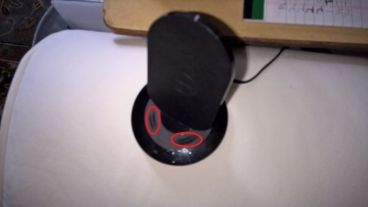

RumoredNow
You mentioned in an earlier post that you're able to use your DT-910 chargers with your RM-938 wearing a case.
I have a JCase Diablo and my new RM-938 keeps sliding out of the DT-910.
I really prefer the look and feel of the naked 1520 but wearing a case is pretty much a necessity.
Which case are you using with your 1520 in the DT-910 chargers?
Has your phone ever been dropped wearing this case?
RumoredNow
Nov 12, 2012
18,134
Visit site
Hmmm.. I'm surprised your phone slides off. Are the ramped rubber feet damaged or missing?
These feet have no issue holding my 1520 on the stand. I would think the rubber bottom portion of the JCase Diablo would provide more grip than the crystal clear acrylic snap on case I'm using. Amazon.com: CoverON? Hard Plastic Slim Case for Nokia Lumia 1520 - with Cover Removal Pry Tool - Clear: Cell Phones & Accessories This is the only case I've used on the 1520 since owning the DT-910 charging stand. The DT-910 also holds my 830 with a similar case and held a naked 928 I used to have.
Is your vibration on? Does the beast simply vibrate off the stand? Have you tried it in Landscape?
I've not dropped my 1520 in a long while and that was when I had a clear TPU rubber slip on case installed.
bilbo_baggins
Jun 1, 2015
12
Visit site
The rubber horns on both of my DT-910s are all intact and no, it is not vibrating out of the stand and yes, the result in the same in vertically or horizontally situated positions.
What may no be obvious about the JCase Diablo (visa vi the DT-910 case) is that the back of the Diablo is extra thick to make room for the folded (retracted) kick-stand. Therefore, when sitting on the DT-910, the phone just naturally sticks out further, beyond the horns intended to retain it.
Therefore, a more important attribute/benefit of the Qi charging and the DT-910 base is that a protective case need not have the extra thickness (and weight) necessary for a built in kick-stand.
