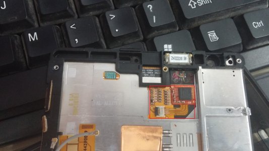

i faced this problem two weeks ago so i decided to open my phone.
the solution is to cover the IC and resistors or capacitors of the touch screen with electrical tape to prevent those components from contacting/grounding the metal shield of the motherboard.
youtube for disassembly guide.

Now this makes lots of sense!

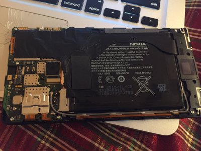

Interesting you post this. I opened my 1520 for the first time recently to replace a faulty/failing battery. Now I'm looking at your pic and I want to ask what phone is this? It looks really different than mine does.
its the same phone, you need to remove the motherboard to get to it.
Side note: where did you get the new battery - Does it charge up to 100% ? It's been made very recently according to the date stamped on it. Lots of people been getting replacement batteries that only charge up to about 83%. Would like to know where to go when I finally replace mine.
(Insulating the exposed circuitry under the motherboard)
Not to me. If it were necessary to insulate that area, Nokia would have done it, wouldn't they? More specifically, it doesn't seem possible for the two bits of circuitry to touch, when I take a close look at mine.
You would think, but things always get overlooked. I don't know what causes the phantom touch issue, in fact my 1520 doesn't even have it (so far) but that looks like a very likely source. If my phone does develop that issue, putting a piece of electrical tape over that area will be the first thing I try. It just makes the most sense to me.

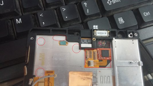

Hi..very glad I found this thread, as on occasions my 1520 gets those darn ghost touches too, I disassembled it and took a close look at the screen assembly and noticed some interesting bits, I see that on your screen there are some white squares and rectangular zone with rubberized look on the top left from the zone you insulated, i'm quite wondering if those are insulation zones too, as there are pins on the motherboard that make contact with these zones, and on my device it seems all these zones are erased where the pin is touching it.
Now this could be a potential grounding problem...as the pins on MB are transferring some charge to the screen frame, but I really don't know if those white squares are insulation points in the first place, as this raises another question, why would Nokia put pins on the MB that will touch there if it would want those points to be insulated.
But then again on your device I see those points are intact, I mean no pin has made it's way through this white thing to touch the alloy display frame.
