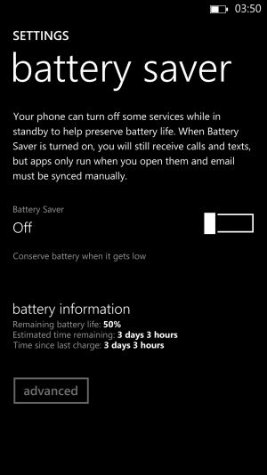

Just checked mine, I'm happy.
HOW YOU DO THAT< CHEATER?!:confused: Jk :amaze:
Any tips on how you achieve that? WHat i get MAX, if I'm lucky, is about 20 hours. Do you have Cellular always on or off? Location? Background tasks? Any help from you would be appreciated.
What about WP8.1 Did the battery life go downhill/improve/stay the same?
I just can't believe unless I see it by my own eyes. 3 days off charge + 3 days remaining at 50%? Sounds photoshopped, as for me :3
Waiting for your reply.
