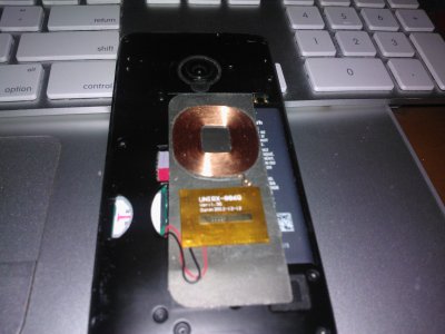

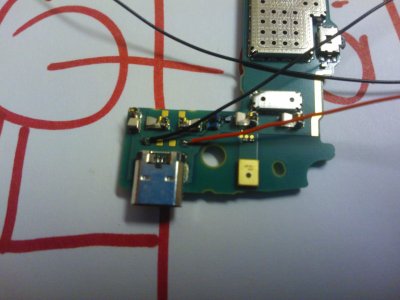

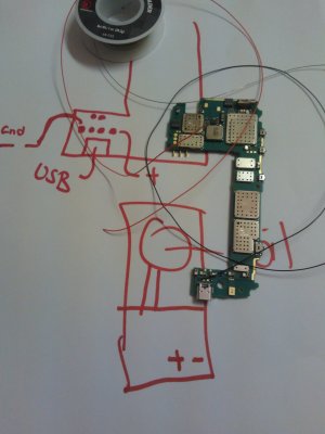

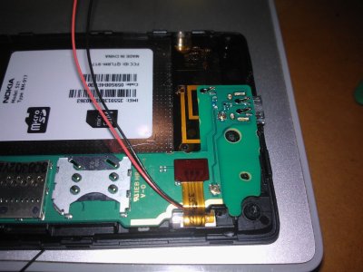

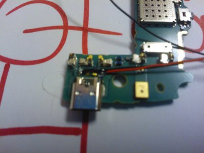

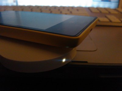

Continuing from my first mod of dying the white Lumia 521 shell to Yellow, I've now added in Qi wireless charging to my Lumia 521. It's a pretty finicky mod, but it works.
Here's some video of it in action.
It's not something to try to do if you've never soldered before, as you can easily ruin the phone. I've documented the process a bit and can answer questions if you want to try it yourself. I don't believe this mod will work on the 520, it does not seem to have these test pads at the bottom for USB like the 521 does.

Huh, not sure how i forgot the last 2 pictures. Edited with them.

It's actually kind of a pain in the ***. I wouldn't recommend doing it. If you look in this picture, the grey material is some kind of shielding, or magnet... or something that makes it all work. Without it, the Qi plate connects to the coil, but after a few seconds errors out and stops charging. Problem is I can't get enough of this material in the 521 to make it work properly (Throw the phone down at any direction/angle on the plate) ..I've already sanded off as much of the plastic inside the case as I can. So it has to be pretty straight on the plate or it won't charge. It was just a proof of concept attempt at adding it in.

So long as you can get to the back side of the micro USB , you can add this to any phone, well, any device really. It's harder at the USB prongs , but it works.
