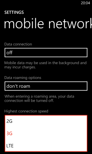

Hello guys ! I got a Lumia 625 (RM 941) of MEA version and ROM, and I can't get the 4G network as the highest speed in the menu, and I want to change my ROM.
Which ROM is the best and it supports 4G ? And is there a handy guide for ROM Flashing ?

Hi ! I appreciate your reply ! But did you consider reading what I said up there ? I can't get the 4G option in the Highest Speed MENU. It's only 2G/3G bro..

The same constatation here, but don't have a 4G network to test, anyway the 4G option is not selectable either (2G and 3G) so I guess it has been pulled out of the ROM because it's useless in MEA.

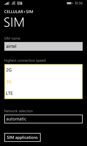

We had also the locked 2G, 3G version & I have flashed to unlock 4G,
Sadly the 4G is unlocked but the Bands supported are 3, 7, 20 (the Deployed one is 40)
use this link... for ref
http+://+forum.xda-developers.com/showthread.php?t=+2515453 [remove +++ from link]
I used "059T3L2 RM-941 VAR APAC CV MY BLACK" you can use same or see where NOKIA sells 625 4G enabled
Enjoy 4G (if it is in BANDS 3, 7, 20 or frequencies - LTE 800 / 1800 / 2600 )

I complete the flashing and the phone restarted itself it was a reset actually. Mine is a rm-941 lumia 625. In the reset it asked me if I needed to restore the old files or start with a clean slate I took the first one and the phone restored and now I am having highest connection as 3G again. I have windows 8.1 preview for debs
