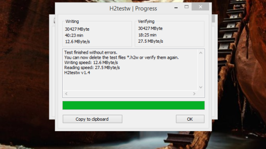

I then formatted the memory card and checked it with a utility h2Testw 1.4 to checked if it was not a fake card , the utility was able to write and verify the 29.7 GB of Data.
Card seems fine according to this.

PS : - I have attached the screenshot of h2testw results
