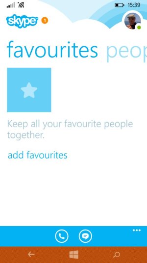

The second issue is around the navigation bar and the fact that it randomly seems to "shade" itself out whereby it gets a stippled overlay over the top that looks terrible. Tapping on any of the bar buttons brings it back again, and it doesn't seem to happen in any particular context as I can go in and out of things without it doing it, then it shades, I press back and it comes back again, and I can go in and out of things again without it happening. I've taken a screenshot of it, but it looks far worse on screen:

The "graying out" of the navbar is not a bug but rather a burn in saver feature for AMOLED displays. Such strong white mainly on static icons on some contrasting backgrounds can lead to temporary burn in which can turn to permanent in the long future.
"Graying out" those areas after some inactivity time, can help reduce/eliminate the problem.
If you cannot bare it, then you should opt for an LCD based WP device.
Thank you, Audigy. That is a great explanation. It's a pity though because the icons look way better on the black with an AMOLED display.
