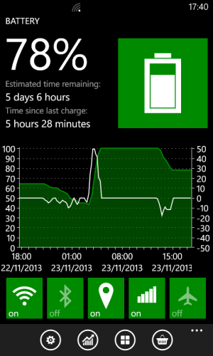

over the last couple of days I have noticed with both my L820 and my wife's L820 the battery estimation/battery drain went from being an average of 1day 15hours to being 12-16hours and that was with NO obvious background activity (all open tasks closed) using GDR3. Then when my battery level was stating 65% with only 4 hours left (nothing running in the background) I just rebooted my phone and that 65% / 4hours jumped to 64% 1day 2hours.
This also happened again today and the same result so I am wondering if there is a bug with Amber that even though all apps are closed there is something that doesn't close fully which causes a battery drain which I would hope will be sorted with Lumia Black.
So for now when I get to approx 6-10 hours from removing the charger and there is a weird battery drain I will be rebooting my phone.
On another note I had a laugh just now all of a sudden my L820 stated 5days 6hours

The estimated time remaining is based on current battery drain and current battery voltage. If you unlock your phone and look at the ETR you will get information about your idle power-drain and battery life. If you want to get accurate data you should process any task you want the battery drain from for 15min.
Crashed background tasks can drain the battery extremely. Sometimes even a restart did not solved my problem. A second one was needed.
If i'm lucky i get 40h out of the battery. Sometimes if something is not right and i don't have the possibility to check my phone often i get 10 hours.
That's a big downside of the battery life. I would be happy if i could really rely on the battery. It sometimes frustrating to listen to music for 20 minutes and seeing my phone lost 30% in this time.
