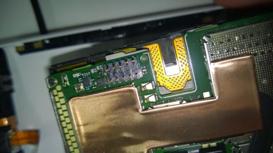

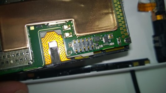

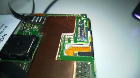

When i opened the phone i've noticed a strange thing, as you can see in the attached images. The flex audio module is in contact with these pins. You can see three pins out of five are not aligned with the others. These pins are not fixed, they can move up and down. Maybe they are the cause of the problems...
I would like to know if it's normal this behaviur (moving pins), and if you have any other suggestions i can try to resolve the audio problem.
