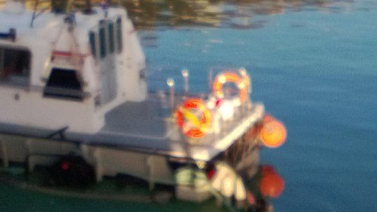

Maybe it's worth uploading our examples of these blurry images...
ATTACH=CONFIG]30961[/ATTACH]
Those pictures are the worse I've ever seen. My 920 take outstanding pictures, day or night! Send that phone in for repairs or replacement! Best advice I can give you!
