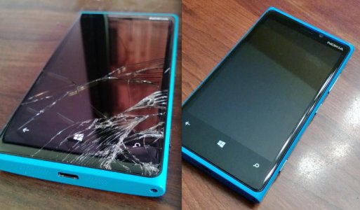

I feel for you. I am happy to report that
have combined to restore my cracked Lumia 920. The only difference is the absence of the AT&T Logo which I consider an improvement. Everything appears to be in working order! The glass+digitizer was shipped from China so there was a bit of a wait while it made its way stateside. Also, there is a 5% discount code mentioned on one of the Le55ons YouTube Lumia videos. That saved a couple bucks. I chose to get the glass+digitizer rather than try to fuse new glass onto the existing digitizer. I'm a patient person, but that seemed too much for me.
Cost: $132 screen + $12 Torx screwdriver = $144.
Before and After:
