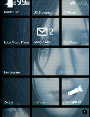

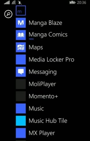

if "Loading" and "Resuming" Screen count as lag and
screen like this also then my Lumia phone is lagging since WP8.1 and nothing solve this not even flashing your device. I think WP8.1 is too heavey for old dual core Lumia devices
This isn't called lag, it's just loading images again since they were removed from memory because an app was using alot of ram. My problem is with the start menu animations.
