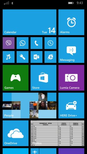

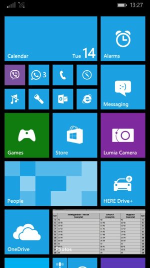

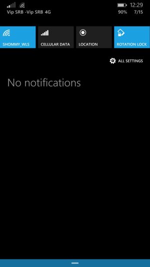

My brand new Lumia 930 has really bad reception, I have 4g network and on my previous Lumia 830 it worked fine, but 930 can't even use 4g because it is always on 2 bars maaaybe 3, I can't talk to anyone, constantly loses connection, wifi also isn't as good as it should be. I've tried switching sim cards, put my sim in friends phone signal is good, and his sim in my phone signal remained weak. So I opent the back cover and found one metal line taped to the battery. Does anybody know what this is, or how to fix reception problem?

I live in Serbia and like I said I had 4G on Lumia 830 all the time.
Yes I've seen those two flex cables and they are attached they can't move, so maybe they are faulty I don't think that software is the issue. I don't want to experimet with opening it myself I still have 24 months of guarantee. And about that wierd metal thingy, yes I believe it is soldered at the top of the phone, maybe the goverment is bugging my phone :grin:
