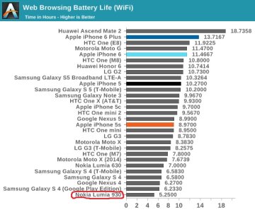

Anandtech has excellent battery life tests, and they say the battery life is horrible.

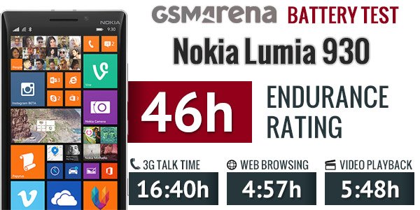

This is GSMArena's assessment, which seems to fall in line with Anandtech's result there.
(Endurance rating is how long the phone will last given one hour of web browsing, video and calls daily - its near the iPhone 4s, HTC One, Blackberry Z10 actually by that metric, although its not representative of all usage patterns)
However, its worth noting its more mediocre than horrible. It's in near the results of the 920.
