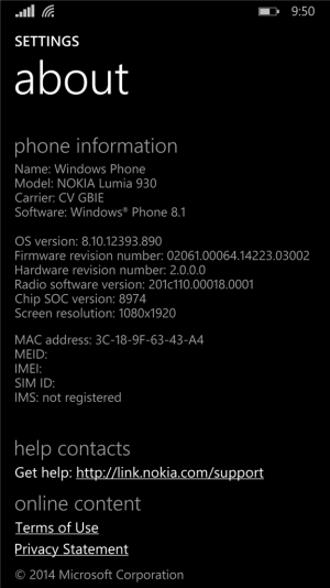

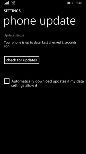

Hey guys,
I live in Morocco and It's been quite a while since the denim update is available on Lumia 930. Unfortunatly, not on mine !!!!
I've been trying to update my firmware from 'Cyan' to 'Denim' several times along the past few months, all I get is : 'Your phone is up to date....'.
I have checked the availability in Morocco: Denim update has been out for more than 2 months now.
I'm litteraly stuck in 'Cyan', can anybody help please ????!
Thanks in advance.
PS: Please view the screenshots for further details.

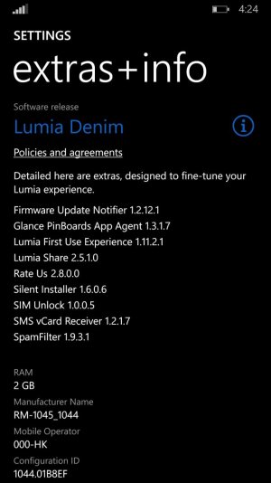

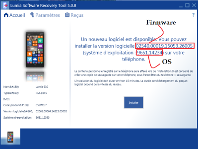

The Recovery Tool worked like a charm, thanks a lot. The variant has now changed from 'CV GBIE' to 'HK', is that a problem ??
One more thing, I couldn't restore my Whatsapp conversations, even if I made several backups before proceeding :/.. Is there any way out ??
Many thanks for your time, here's a screenie with the new build:
That's great! Mine is HK variant...no problems in that regard. Lumia camera is really good and don't forget to try "hey Cortana".
