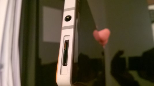

Well I received my handset back again last Tuesday and it already has same problem. So annoyed. I sent a letter with the parcel explaining that since the initial repair the problem was intermittent and not permanent and also highlighted where there was screen lift. To my dismay when going on the nokia track my repair I could see that it was with someone for less than 10 mins before being deemed not faulty with no mention about the screen either and it was being dispatched back to me. I immediately contacted the support person I was in contact with and said I was really concerned about getting it back wrong. They managed to re-route the handset to check for themselves and they agreed that the screen was lifted once they checked themselves. They then organised for the phone to go back to the repair centre to get the screen sorted. It arrived back and looked much better, plus I could tell they replaced the frame as my original one had a small mark on it. However, a week on and that area in top right is once again lifted and causes double tap not to work and screen to stay black on a call. If I squeeze that area together first it works fine and on a call but after a short time happens again. Yesterday morning I took the back cover off, which was surprisingly easy and tightened a screw in that area and lo and behold it started working again fine despite the screen lift. However, today it is happening again. I will highlight this again to them but have reached the point where I just cannot be bothered to send it back in, especially at xmas when I could do with the handset for pictures etc.

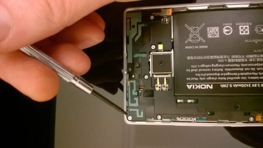

If you do that again, it would be perfect to ad some picture with a screw which need to be screwed.

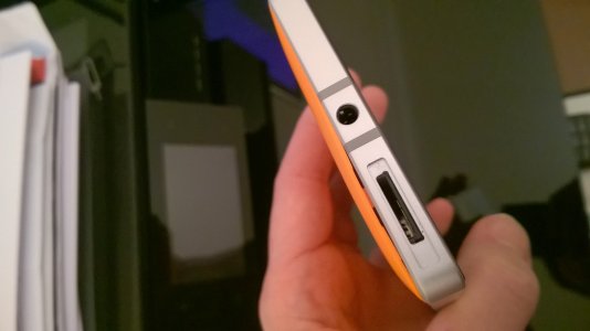

Upper right corner of my L930 is little lifted but for now everything works fine.

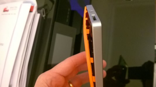

Ok sure. The back is actually pretty easy to get off but I don't recommend people do it if they don't feel comfortable with it. Basically when the sim tray is fully removed you can see a small portion of the back cover poking through which is like a clip. If you gently press against that with a small flat tool you can pop it out. Then you can gently prise off the back cover which is just basically clipped in around the frame. Then when you turn the device over screen side down you can see a small hex type screw (size t5). Mine was a little loose so I tightened it some more, this immediately got it working again. Today for some reason it was acting up again but this evening its fine again. It could be just coincidence but I think it is something to do with that because before I did this it would work when pressing the area together so it got me thinking whether something wasn't quite tightened up enough. I will sort a couple of pictures out to show you what I mean but in the meantime if you search Nokia Lumia 930 disassembly on something like youtube you can see something take everything apart. I have an orange Lumia 930 and I've ordered a black back now because I would like to see that back cover with the aluminium frame. I like the idea of it over the all black one.

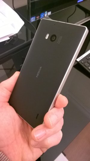

My black replacement cover arrived today. I like the look against the aluminium. Only thing is it didn't have the flash module so had to take that off the original one and doesn't have the wireless charging parts in it!! I think I could probably peel off the connectors from the old one to charge but not confident to do it.
