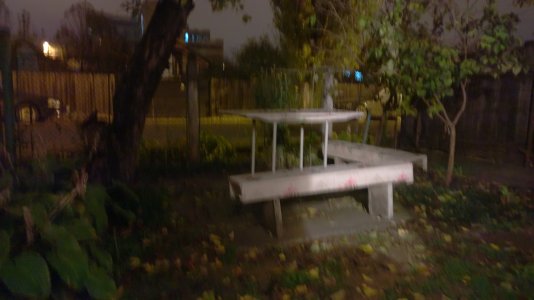

After i got my Lumia 930, i tested it's camera in almost pitch black conditions without flash. So i set the shutter to 4 sec and low ISO and tried to hold the phone steady (supporting my hands on a bench) and see what happens. What i got was a blurred mess. Decreased the shutter time to 3 seconds...same result. So i basically thought the only way you can get decent results is by using a camera grip, considering that all OIS systems on phones give the same bad results.
Until I saw this review ( not sure if i can post the link to it, will edit later if yes) that pits the 830 vs 930 vs 1020 vs Galaxy K zoom in total darkness, using manual shutter speed and iso and no flash, like i did. All did a fantastic job handheld, except for the 930, that got results similar to mine. (fuzzy images)
I would like to know if any of you tested their L930/Icon in these conditions ( 3-4 sec shutter speed, 100 ISO, handheld supported or not and no flash) and if so what are your results... You can post them here if you like.
That way i can find out if i have a faulty device (small chance considering the reviewer got similar results) or the OIS on L930 is very bad compared to other phones.
This is the best result i could come up with. 3.2sec shutter time, 100 ISO no flash. The scene was much darker than in the photo, but still this is very fuzzy. The rest are just too bad to even post them.

I did some more testing and placed the phone vertically on my desk and chose a 2 sec timer, to eliminate initial vibrations when pressing the key. After i pressed the key to take the picture, the phone vibrated a bit, causing the lens to float slowly into place, and when the shutter opened to take in the light, the lens was still moving slowly instead of the OIS locking it into place, causing a blurred image even if the phone was on a still desk and i was keeping my breath and was not touching it or the desk.
After i chosen a 5 sec timer, the lens had time to settle again after i pressed the key to take the photo, and when the shutter opened the image was perfectly still, not still falling into place like in the example above. The end result was perfect.
So i came to the conclusion that the OIS fails to try and lock the lens into place once the shutter opens, if this occurs when the lens are still settling.
Knowing this i improved my images allot, but basically i learned how to avoid the consequences of the OIS, without taking advantage of it at all... But than again maybe I am wrong and the OIS actually kicks in while the shutter is open and cancels some small vibrations, i don;t know.
