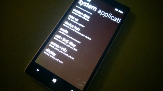

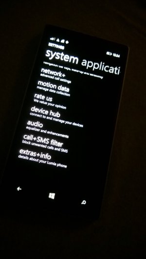

Hello, today I got my 930 and was shocked when I saw the bleeding on the Display.
After playing around with it I figured it has to be the Display App/Driver, so I set the Date to 2300 and uninstalled it, and the Display works like a charm! Blacks look like they're supposed to and theres no more "bleeding"! And no Purple hue!
All you have to do is:
Set your date to the year 2300
go to Settings, Store, disable automatic App Updates (Just in case)
go to Settings, tap on Display, since by 2300 the certificate for the Display App would have expired, you can uninstall it. Now restart your phone and set the correct year again. No more Purple where black should be, no more reddish bleeding! I don't know if there are any other negative consequences about this method, but it seems to work so far. I hope I could help! I'll attach before and after pictures :)
Pictures were taken under exact same conditions, only 2 minutes apart.

Do you still see a brightness difference or gradient colors if you display a solid dark grey picture across the whole screen? Try changing your alarm clock time, the system grey background reveals this.
This only fixes the "backlight bleeding" on blacks that are supposed to be black but are for some reason lit up anyway. However this does not fix the brightness problem I'm facing (top of the display brighter than bottom).

Hm, I don't seem to have the problem with greys you are describing. I'll try to take a picture in a darker environment later today though! Sorry to hear it didn't help an your device :(
Thanks alot, just upgraded today from my Lumia 1520 and was losing my mind over the red color bleeding on black and grey colors, now after following ur steps even at full brightness colors are fine and black and grey are like my Lumia 1520. hope they fix this soon as this is most likely a software issue.

Gradient darkness issue is fixed (same as OP), purple tinge seems to have gone, and colours look more vibrant.
Purple tinge is gone. Great.
Yes colors seems to more vibrant - to a point where you could argue it's too much - but it's okay untill MS fix the Display-App.
Thanks!
