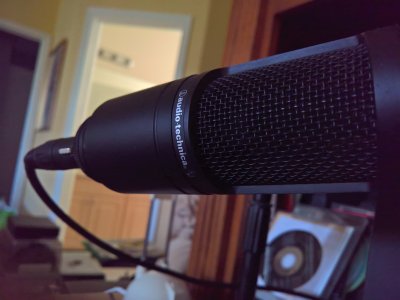

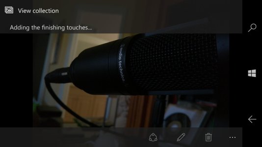

- And the worst thing has been the CAMERA which everyone seems to rave about but gives me very poor images due to it always touching up my pictures without me prompting it to. I will attach pictures and I did start my own thread about it and no one spoke on it.
There's a setting in the camera app to disable automatic retouching. I believe it's the option called "Capture Living Images". Once I noticed it happening it was the first thing I disabled. I think what it does is output variations of the same image, and then in the photo app you can switch between the choices to find the version you prefer. In my very brief testing I found that the standard version is the best anyway.
So far I've been extremely happy with the photos taken by this phone.
I disabled that immediately it made no change aside from it not taking living images. That only controls whether or not you'll also get that short video like thing in your preview.
