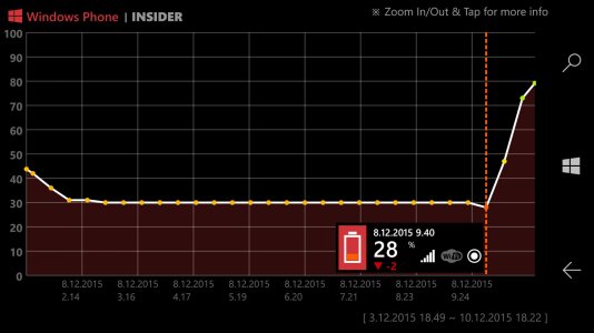

For me the battery drain is not bad but i always put flight mode on to nights. Backrounds from Edge, Facebook and store are off (L950)

how did you disable the hey cortana option, my phone has been on since 7am today and really havent used it that hard, bit of facebook (posted a couple of pics), browsing email etc but not alot and played some music via bluetooth speaker for 30mins and at 9pm its at 15% which is a worry, i was hoping for more and would understand if i was playing games or something heavy.
