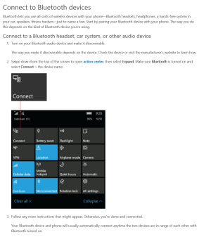

It say here that you may need to use the CONNECT toggle to select your device????? I am using a Plantronics Savi 7xx and it is like going through a friggin maze to get connected on the second call. I had it down pat 2 weeks ago, went out of town, returned...and now I have to remember the dog and pony show, to use my damn Headset.
Mutant, if you try the above (or have tried the above), please let me know if it was successful for you. I'm sure my customers just love my hanging up them.

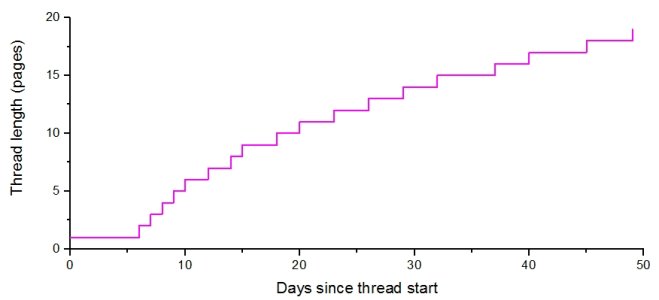

Just for fun, here's a graph of the length of this thread since it got started. The good news, it's slowing down. The bad news: it's still growing pretty quickly!
