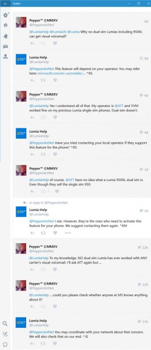

I am going to contact ATT, see if I can get through to someone who has tech knowledge, see if they can provision my 950XL IMEI as a 950, since it should have the exact same capabilities as far as they are concerned.

I just got done chatting with "Eric" at AT&T. He seemed quite knowledgeable, and said he's had 3 other 950XL support cases this week. One thing he mentioned was to wait 3-6 months, by then MS and ATT should have an agreement in place which simply means that Microsoft provides AT&T with a list of the IMEI numbers, and AT&T load them in their system and assign it a configuration. At that point things should work right.
Unless and until the WP OS supports VVM on dual-SIM devices, nothing AT&T does will get VVM working on dual-SIM 950/950XL handsets. This is not a provisioning issue, it's an issue with what WP supports, and its built-in VVM is not currently supported on dual-SIM devices. Period.

Built-in VVM is unequivocally not supported on dual-SIM WP devices currently.
You keep saying that, you also keep not providing a reference. How do you know this to be unequivocally a fact?
