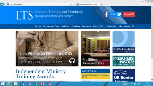

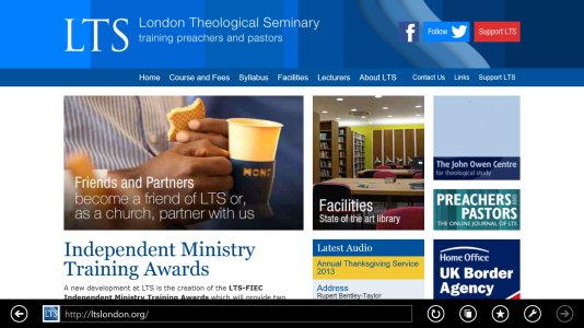

I discovered an odd thing yesterday at a meeting. I was showing a client an site I designed which has a horizontal gradient in the header.
In the metro IE the gradient had vertical lines in and was effectively in several large blocks of colour (a bit like if someone had converted it to 8 bit colour but without dithering), see below. Also the John Owen Centre logo (far right below the menu) doesn't show the circles that are clearly visible in the desktop view.
Yet on the desktop version of IE the gradient displayed perfectly. John Owen Centre logo clearly displayed.

i have the same problem on my surface 2. However it's not only occuring in the Metro IE but everywhere on my Surface. All color gradients look horrible, even some tiles. They have those color blocks as well. I hope they will fix that in an up comming update...
I think i just need the latest drivers... They didn't get upgraded...
Hi Dice, I created a USB recovery drive and did a system reset from that. The drivers still don't get updated correctly (Tegra drivers not updating / BSOD on system refresh).
However, now the colours display correctly.
My guess (and I stress it's a guess) is that because I was getting a BSOD when trying to reset/refresh from the recovery partition, there was some corruption when the device completed the process after the BSOD.
Doing it from a USB drive means no BSOD and perhaps, no corruption.
It's a pain to reset the device but it might be worth a go.
NB: I think I might have run the screen calibration utility from the desktop before noticing the issue, perhaps that caused the problem.
