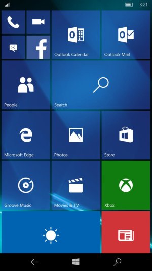

then it comes the home screen. as you can see in my profile pic, the 000-hk default home screen contains some useless tiles in my opinion. the "continuum" tile is useless. i am a heavy user of continuum. i use my 950xl as a computer in my work. i connect it to the dock 8 hours per day but i never touch the "continuum" tile. continuum mode establishes automatically every time i connect my phone to the dock. it just happens automatically. no need to set anything. no need to tap that "continuum" tile. what's the point of placing a continuum tile there? i don't understand.....
000-88 default home screen doesn't have the continuum tile.
another useless tile is the "camera". 950xl have physical camera button. i use that physical button every time i need camera. i never tap that camera tile.
000-88 default home screen doesn't have the camera tile.
besides these two, there are lumia creative studio, fitbit and lumia help+tips at the bottom of 000-hk's default home screen. i seldom use them. i use fitbit but i do not need to check it frequently. 000-88 default home screen doesn't have the lumia creative studio, fitbit and lumia help+tips tiles.
next to the "money" tile, 000-hk places the "news" while 000-88 places the "weather". the latter is more useful as a tile.
000-hk pre-installs amazon, south china morning post, gameloft hub, shazam. you will see them after a factory reset. 000-88 doesn't come with them.
