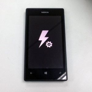

My Lumia 640 xl is not working and I can not hard reset it . I have a spark on the screen. How can I fix it?
W
WPCentral Question
my lumia640 xl is not working and i can not hard reset it .i have a spark on its screen
i wanted to reset it.something went wrong and windows cauld not start and sad face appears.now i have a spark icon on my screen .can you help me to reset the phone starting from this spark

Re: my lumia640 xl is not working and i can not hard reset it .i have a spark on its screen
Does it look like this?
All is not lost.
Power off the phone > hold Volume Down > press Power > keep holding Volume Down until you see the exclamation (!) screen, then immediately release the Volume Down
Now tap Volume Up / Volume Down / Power / Volume Down
You should see the spinning gears and your phone will reflash the last OS version held in recovery. You do loose data, but get your phone back. Sign into your Microsoft Account and restore your backup during the set up.
