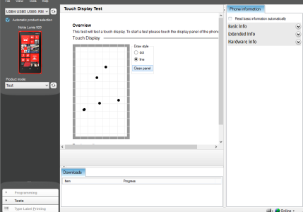

EDIT : It's definitely not a hardware problem. I used the test program of Nokia Care Suite many times.
The Screen detects every contact.
I'm sure it's a software problem, but even with nokia recovery tool , i can't seem to repair it.
