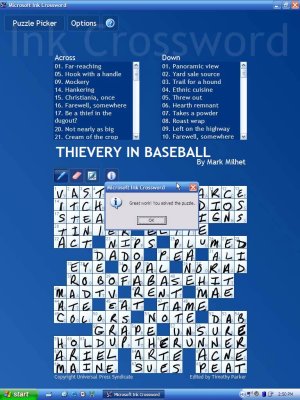

Not all that different from this back in 2005:
