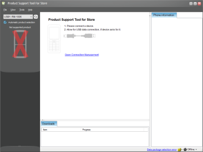

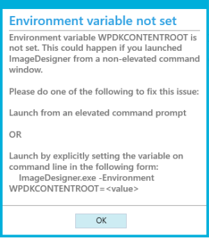

I have a good ROM for my 640 XL LTE Dual Sim, but I am unable to flash it using either Nokia Care Suite or "LumiaFlashTools" from the xda site.
Is there another method?
You've tried the two best methods out there. You may try Windows Device Recovery Tool by pointing to the rom folder (tap on three dots, settings, packages, custom path. Try flashing from a cold boot and have the recovery tool pick up the device before it boots. Try to force it into recovery mode on boot (from off state, press power button and then vol down until you see the exclamation mark). If that still doesn't work you may want to try this on a different PC. If that fails then I'm afraid you have a brick if the phone doesn't boot (not clear whether you are trying to install this rom onto a working phone or a non-working phone).

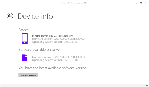

I get this when I follow the steps you outlined:
