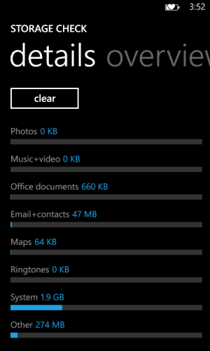

wait indonesian firmware is in 1030.6470.1308.2 > RM-846 VAR APAC Indonesia ID CV (059R4K7) , is it safe for my lumia 620 non-sim/factory unlocked using this firmware ? my lumia now is using 1030.5603.1250.1 ,, and WP8 firmware size is 1.3GB ?
my factory fw is 1030.5603.1304.6 from malaysia,before the newest firmware rolling out,i tried china n india fw,and i don't have any issue(after that i going back to factory fw)...i think it is safe to flash any fw,as long u know to right step....yeah,those fw are more than 1 GB.......
if u successing to flash 1030.6470.xxxxx fw,rmb to update the ''extras+update'' apps to enable clean storage apps......u can scan it via the barcode below then click update..
Storage+check clears only temp files, doesnt clear from other. Nokia updates doesnt gets downloaded automatically on firmware 1030.5603.1304 & 1030.6407.1308.

this is my firs time flashing wp device , so you already in latest 1308 firmware right is there any performance change or just storage+check that changed ? , i'm still downloading
well,its better than nothing,before storage apps,my other,once grow to 1gb above.Even when i dont have any apps,''others'' hover around 400mb(300mb after factory reset)...the storage check did help me keeping the other below 300mb while i installed essential apps...i would not say it completely solve the problem,but it does help :-)
I din't notice any performance change or anything else other than storage check(the display+touch apps did updated)...pls share if u found anything else :-)
Stability might increase but no performance improvement as windows builds remains same,nokia may be tweaking only some device drivers not the OS.

Hey i bot my new l620 a month ago... Updated once. Bt my others grew nw 1.9gb, i hav to do sumthing to clear it. New firmwares hav an option i heard. I downloaded it from navifirm, but i hav no idea how to flash it on my device... Can u help me step by step.. M a new windows phone user... Thanx
