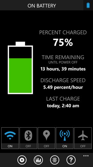

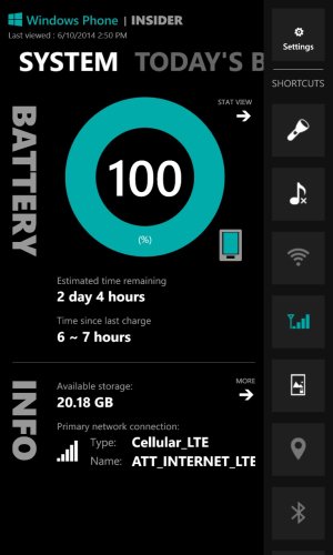

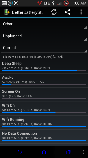

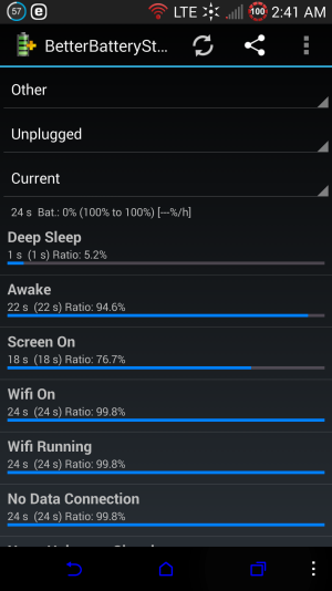

The battery life on the Icon is pretty bad in general. At least compared to my M8.
On idle it drains at 3.0%+ per hour. My M8 on idle drains at 0.7% an hour. I took the following screenshots which showed the difference. This is with the exact same stuff enabled on both (wifi, cell data, location).
