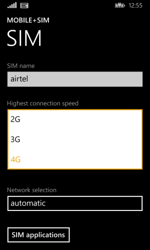

No you have mistaken your phone supports 4G band.I have 4G option to choose in my Lumia 925 coz Microsoft enabled it in latest dev preview build 8.10.14203.206 (otherwise denim ).......4G option is added as the ?Highest connection speed? in India. Don?t know whether this holds for some other regions too...
Here is a screenshot of it
I am not using it since 4G services are not yet enabled in my area eventhough I have 4G sim :)
If u r on latest build you get to choose 4G option :)
