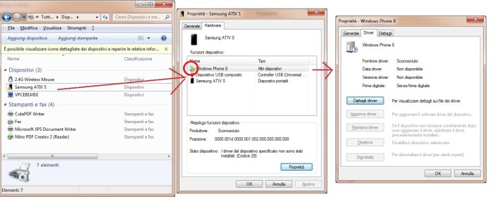

From the picture that our mates posted above, it seems that on PC which correctly recognize ATIV, we can deduce that the driver installed is named winSUB.sys. So what I did was to "force" windows to install that file (which I have in the computer...in the right windows system folder). It did not work.
Even if I copy and paste the winusb.inf and winusb.sys from a different PC running windows 8 instead of windows 7, it refuses to install them saying that the class is wrong.
So again, no problem on a windows 8 PC, while on windows 7 ATIV is not recognized (tried with two different PC, 3 different cables, all USB ports, with and without an SD installed).
The phone is brand new and it works perfectly. My only issue is this exclamation point which persists in the system, associated to the third component as shown in the image here.

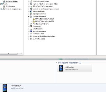

For some reason my W7x64 laptop and my W7 x64 workstation had no problem finding the driver for my phone. Yet, the x64 at my office, I am an admin in the company so no problems there, did not find my drivers during the last couple of weeks since I got the phone. I could not find any major differences except maybe my installed Windows developer toolkit for my W7(.8) HD2 phone. So for weeks I searched the fora and read all kind of things about WinUSB but I didn't take the time to get the files from my other PC to put them on my Office PC until today. And like I read before, the files I coun't find with a search for winusb already appeared to be in my system. Now all I needed to do is to direct my device manager at the point where it want's to add the driver to the right location. And now it all works fine. Nevertheless and strangely enough my phone still seems unrecognized by the system. Neither is there any WinUB device found. (screenshot1)
Yet! My PC's interface seems to have no problem with that. It sees my phone, downloads the right icon (Nokia820) and lets me sync & exchange files between my phone and PC thru the old Phone App, WMPlayer or through the explorer. And after installing the new Phone App, ejecting the phone, restarting my PC, device manager still does not recognize the phone and all syncing and file exchanges still work! Success at last. And being the nerd I am I will of course not stop untill I have been able to remove the faulty devices from my Device manager. And I'll let you know how I did that. I hope some W7 x64 users will now finally be able to enjoy their Nokia's.
P.S. Location to direct the driversearch to is [systemdrive]:\Windows\winsxs. Let me know if it doesn't work the first time.
