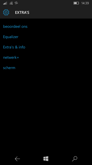

I no longer seem to have Glance settings on Windows 10 Mobile. I read suggestions to go to the Store (microsoft.com/nl-nl/store/apps/glance-screen/9wzdncrfj3ds), but is says ''This app isn't compatible with your device.'' Glance is still working, but I want to change the settings.
Any other suggestions? Thanks in advance.
Have you looked in Settings for Glance? Swipe down from the top of the screen to open the Notification Center, choose All Settings, then type Glance into the search box at the top of the screen. Does Glance Settings show up?
Unfortunately not. Looking at the ''Extra'' settings, it seems other things are missing to. I'm wondering if I'm missing a firmware update, but it says there are no updates available.
