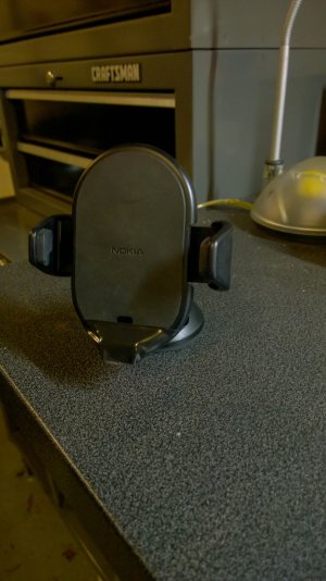

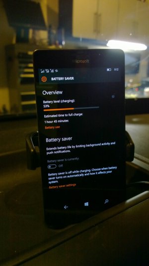

I got the Nokia CR-200 Wireless Car Charger to recognize the Lumia 950XL by cutting off the bottom piece so the phone is positioned lower. The phone now rests on top of the dash instead of the cradle. See the pics.
If you're willing to do this mod be aware that there is a wire inside so you have to cut around it so you can bend the wire down. I actually cut the right side but the phone was still recognized so I'm not sure if the wire was needed or not. But I soldered mine back on just in case. It doesn't really sit flush on the charger but it gets recognized and charges so it's good enough for me.

If you're willing to do this mod be aware that there is a wire inside so you have to cut around it so you can bend the wire down. I actually cut the right side but the phone was still recognized so I'm not sure if the wire was needed or not. But I soldered mine back on just in case. It doesn't really sit flush on the charger but it's get's recognized and charges so it's good enough for me.

I was really avoiding cutting open the cradle, but looks like there's no good option left.
