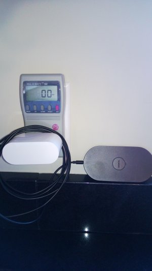

So me being a efficiency freak hooked my new Nokia DT-900 charging plate up to my Kill-a-Watt and did some quick tests.
Surprisingly NO, as in 0.0, Watts, Volts or Amps registered until I put my 920 down on the plate!
So good news, don't worry about leaving them plugged in all the time.

Ok, my killawatt reads 0 watts when the 920 is off the charger, 7-8 when on the charger and charging and then 4-5 when fully charged.
Charging cost (8W) = 0.1p per hour
Idle cost (5W) = 0.07p per hour
Phone not on charger = 0.00...
Basically way less than a penny a day for normal use.

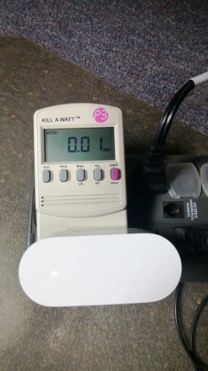

Now I can't wait to test this on my Kill-a-watt! I have the DT-910 that I can test against the DT-900.
I know, I promised to test the DT-910 a month ago but here we go.
I tested the DT-910, the vertical stand with NFC and after 24 hours I showed only .01 KW/H used. During this trial I never charged a phone, I only wanted to see how much power it would use in between charges. Later today I hope to try testing my phone on it to see what kind of power drain to expect. The goal is to see how much energy becomes heat while charging.
I use my Kil-a-watt to test everything in my apartment and to understand how different settings on devices change the power consumption. While I cannot say flat out how much it has saved me, it does allow me to understand the status of my tech habit.
