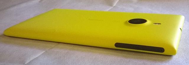

Thanks. As a proud owner of a Lumia 1520.3 (RM-938) I am sort of invested in knowing about this device. I did a ton of research back before I purchased in August 2014 and try to keep up to date.
Here's a picture of my "Bumble Bee"
