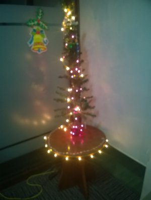

Stupid question, but is your camera glass clean? Grease smudge may cause photos to look out of focus. Also, did you drop your phone prior to that problem? Try setting focus to inifinity and capture a picture. Then, also capture a picture of something up close, again using manual focus.
Post the photos here and we might be able to find out the problem. If not, you may want to get it checked in a Lumia store, whatever it's called now.

Here is a sample photo taken with Lumia camera on manual focus. Without manual focus any object more than couple of feet will look blurry.
Infinity and auto focus look almost same.
