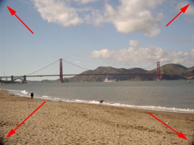

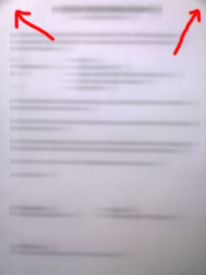

My Lumia 720 camera suffering vignetting now
dark spot appear at every corner of the camera
it will effect all 720 camera because of the low aperture
Here is my camera looks like now:
yeap I just check the vignetting issue on my lumia 720 come after update to amber
I hope it can fix after update to black and not permanently because of hardware
Permanently, neah..I doubt it. Amber screwed up camera quality for most of the phones. As I've seen from some AT&T users with 1020 that received the Black update the camera algorithm is fixed so I hope that for all devices, the current problems will be solved.

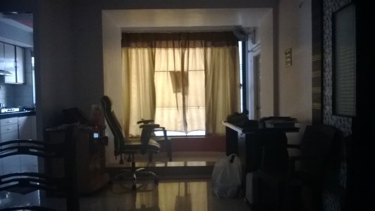

hello everybody i have been following this thread for a while now and have been facing the sane problem since i ordered my lumia online. i even updated it to gdr3 but that has solved nothing except for the same dirty yellowish tinted photos and when i zoom that o god! dn't even want to talk about that please please if someone is listening help me

pls someone suggest me a solution i havnt even got a single good pic from my device camera
also i am attaching a pic to prove my point

Well i guess you have the best of both worlds right there in your hands!
Seeing as you have an appointment with Nokia Care, perhaps it would be best to let them diagnose the phone first to see if the hardware is ok, etc..
Upon receiving it back, you could then decide if the problem is fixed with your phone or if it remains a software issue.
If it is a software issue, you could try and revert to earlier firmwares to see if that resets your camera algorithms to something that you are happier with.
As for 100% guarantee on original camera quality, that hope is purely subjective and i suspect each individual handset will behave slightly differently. Having said that, it fixed my problems with the camera. Your mileage may vary.
As for waiting for black update, i just don't know. I will of course be trying out Lumia black when it arrives and hope it resolves the camera algorithm to something more usable.
All the best!
