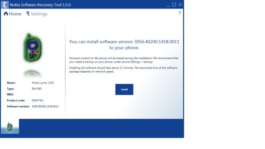

Nokia Recovery Tool wants to install this-is it WP8?
First, the 1320 drawing is AWESOME! Haha
Second, what is your 1320 on, WP8, WP8.1 DP, or WP8.1/Cyan? You can check to see if the firmware version matches your phone's version by going to Settings>About> Firmware revision number.
im on 8.1 dp its rm 995 cricket, what im asking is its offering to install 8.0 right? not 8.1? thanks
Okay. Check your firmware on your phone. If the firmware revision number from the Nokia Recovery Tool matches the one that you have on your phone with WP8.1DP, then it will revert back to 8.0. However, if the firmware revision number doesn't match, then that's probably 8.1/Cyan.
Hope this helps.
