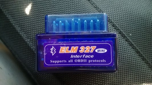

I cannot get the ELM 327 Mini to stay connected to Bluetooth. It will connect for three seconds then disconnects.
First thing, try your device on a different car. I've seen reports where some cars just don't work. If the device doesn't work on other cars, then you can assume your device is at fault. In that case, there are a lot of different ELM 327 devices out there. In my case, the Vgate device did work for me.
Which one did you have? I think the one I have was deamed a "super mini"...it was half the length of the VGate one, and doesn't really have a brand new writen on it.

I don't know if the pic attached or not but this is what I bought.
Here's the ebay link:
Mini ELM327 V1 5 OBD2 II Bluetooth Car Auto Diagnostic Interface Scanner Tool | eBay

That is the exact device that I had. Worked fine on my 2008 Nissan Altima with my Nokia 920...then I just tried it again and nothing. Wouldn't work with an 04 Pontiac or 06 GMC either...it is just straight up busted.

Got my 925 in the mail and set it up same as my 810. Tried connecting to the bluetooth ELM327 mini and same thing happens. Connects for a few seconds and disconnects. Weird thing is, it connects fine and stays connected to my Surface 2 but there is only one app that supports it and its a pay app. So if it sucks, I'm out $2.50.

1) just my observation here, but if that Mini Elm327 of yours doesn't work with your 925, 810, your car, nor your wife's car, seems to me that OBD device is the problem. It would be like my BAFXpro, it just doesn't connect to certain WP. You may want to try the Vgate device. I also have the free trial Diagnose Your Car app for WP8 and it works fine on my 920.
