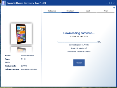

My lumia 1320 cannot see the update!!!!!!!!!!! The nokia toolv1.4.3 wants to install the same version that the phone already has! .1407.0002-what a fun.
Did reset twice to try the luck-but al sh*t! No update to cyan. I am in India. The phone is set to Indian time and all.

I reset the phone to factory .
Unregister from developer.
Gave it for update from settings>phone update
but never see the cyan update!
Tried with nokia recovery tools v1.4.3 - it wants to download the same thing what the mobile already has!

YES, whoever has the upload..many many many thanks. It worked
0.Download the file and extract it which will create a folder of its own - RM-994.
1. On nokia recovery tools - go to settings and point 'downloads' to RM-994.
3. It will check the files and compare with the connected phone and down grade to wp8.0.
4. There after normal update and truly very lengthy updates. Almost all the apps get updated one after another.
But it works.
