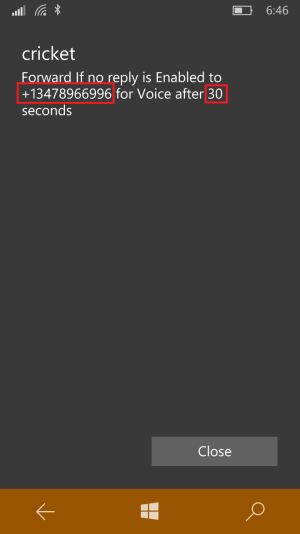

It's actually set by the carrier... And you can change it.
Open the Phone App and dial *#61# then press "Call"
This gives you a screen like so:
You can verify how long the phone rings, mine was 20 seconds by default on Straight Talk and Cricket. 20 seconds seems to be the norm now.
Make note of the +xxxxxxxxxxx number. I mean literally, write it down. > tap Close.
Dial **61*+xxxxxxxxxxx*11*yy then press "Call"
This will instruct your network. +xxxxxxxxxxx needs to be the number showing from your lookup and yy is the number of seconds you want the phone to ring. It must be in 05 second increments and you can only go to a max of 30.

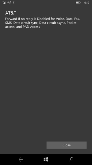

RumoredNow, it "works" for me on AT&T, but does not give the expected results. Here's a screenshot of what I'm getting.
I'm all like, "What is that supposed to mean, exactly?"
Looks like they are outlining the dimensions of the ball-park. Same ball-park though. "Forward if" statement.

Ahem! Got to have the number to program first. It doesn't provide said number. :P
Now, if I go into phone settings, is that the "default voicemail number" listed? It gives me a number there. If that's the same, then I'll give it a shot.
The number revealed by the hash code = the forward to for my YouMail.
So if you have the ability to lookup the number forwarded to for your VVM service, that would be the +xxxxxxxxxxx
Well, I think I'm just not going to mess with it at this time. Seems AT&T has disabled forwarding on their end for some reason, so until I get that straightened out through them, I'll hold off. I need that forwarding ability, and am supposed to have it. It was present on my last 640.
