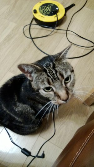

The cat head is more blurry than the floor suggests a very long shutter speed as the extra blur of the head is the cat moving, not the camera. Though, without EXIF data (shutter speed, aperture etc) it's impossible to say for sure what happened.

Focus on that sample does look to be more on the chair than the cat though. You sure it's not in macro mode? As I said, reset the camera app menu options.
You and/or your subject are moving too much. I will admit the iphone to me is the easiest phone to take good pictures with. However after a couple of tries I can get a better picture than my brother' iphone. if my subject is stationary I rarely need more than one shot though. I use the stock app and all default settings.

As you can see by the shot, I held the camera pretty still as evidenced by the sofa not being blurred and the floor also.
It just seems that any movement any of the object, no matter how small, gives blurred shots.
I don't know if the EXIF data is uploaded in the shot, but it gives a shutter speed of f1/13 and ISO of 640. No Flash. File size is 1.95mb

Well, at 1/13 hardly any movement is going to be frozen, great shutter speed for panning though! You need a way lower shutter speed to freeze most movements of the cat, 1/50 is often a minimum even if the cat is pretty still but under 1/100 is preferable. For example when I shoot sports with my DSLR I keep it bellow 1/640 to freeze most movements, 1/1000 and lower is often the aim. No camera is going to go around the shutter speed limit as it's a physical law.
When you make videos the blur actually helps it look natural to our brain and most of us are used to quite slow shutter speeds as they give the "film look" with the extra blur.
Actually having the stationary objects that sharp at 1/13 is quite impressive, that's the OIS.

It is now well known that the default camera application on the 920 is buggy and has difficulty in focusing. There is a thread all about this on the official Nokia Support forum plus there have been a few discussions about this on this forum too. The GDR2/Amber update is supposed to address this problem by introducing new algorithms for the camera. We can safely say that the problem is software related because if you install Camera360 and take some pictures using the manual focus mode your shots will be spot on.

f1/13 is not the shutter speed, it's the lens focal ratio... The shutter speed is measured in seconds.

It is f/2, Shutter Speed 1/13 & ISO 640
Unfortunately OIS does not handle moving subjects very well. Because it can keep the lens steady, it opens the shutter for a longer period of time. The trade off for letting in more light is that you get blurrier pictures. It happens with my cat as well. Try turning the lights off in your bedroom for example and then take a picture with the iphone and your lumia 920. You'll immediately notice the benefit of the OIS
Yep, the phone "knows" it got OIS so it keeps the shutter open a bit longer than on non-stabilized units to keep ISO down and image quality up. It works great for stationary objects and landscapes but the backside is that if the subject itself moves the OIS won't compensate for that movement. In the end you end up with great sharp low ISO surroundings but a blurry subject. I think it's a good priority though and when you need to freeze movement you have to force it to choose a faster shutter at the cost of overall image quality.
