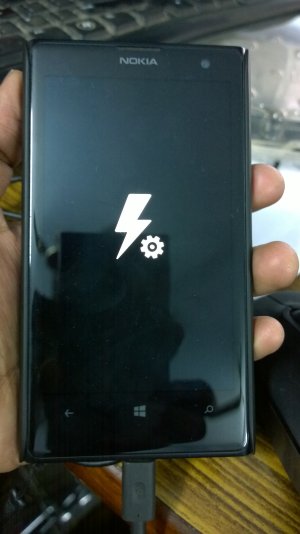

Can anyone please explain, what do this symbol mean ?
After "Restart-Loop" bug in 10080 build on my 1020, while trying Hard Reset via HW buttons step, on pressing VolumeUp,Volume Down, Power, Volume Down, this still image is showing on screen, with no spinning gears. Neither Lumia/Windows Phone Recovery Tools detecting phone as well.
Help me Please !
I think you may have entered "Flash" mode on accident. Try letting the battery drain completely, then recharge it and see if Recovery Tool detects it. You can find a few posts on here about it, as well as on Bing.
Mine got into a boot loop too. I just left it plugged in to loop for an hour or two, and came back to it fully booted up. Just leave it for a while and see if it fixes itself :)
