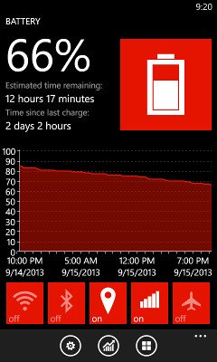

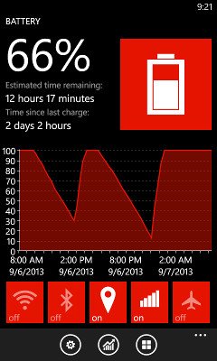

By the way. Mine has stopped the wild battery drain for now. It's just been three days, but I'm hopeful that it will hold. Although I have no reason to believe it won't come back because it's done this before. I.m resisting going to pre-Amber to get rid of it. But if it crops up again, I may have to try that. Finally figured out how to do screen shots so here's a comparison of what it graphs like when it's normal and when it's dropping like the blood pressure of the doomed...
Now I don't know how Nokia can look at that and say nothing is wrong. (Although they have "paused" the Amber update, so maybe they have figured out that something is wrong.) It's the same phone, the same apps, etc. I can't figure out what sets it off but it's not anything I can control.
