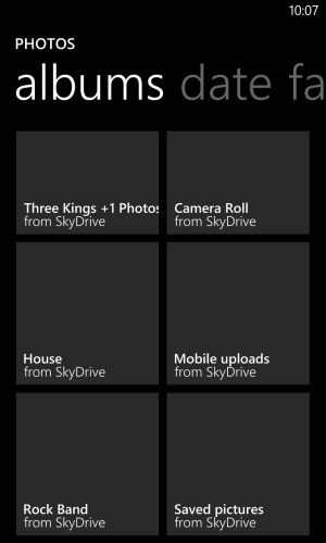

I'm not sure what caused this, but for some reason my photos stored on my Skydrive no longer show images in folder previews in the Photos Hub. It used to work, but I have no idea why it stopped... Pictures stored on my phone, or pulled from Facebook work fine, but anything coming from Skydrive no longer shows the preview... It's almost as if they are empty folder, but they aren't.
Anyone have any idea why? It's not the worst problem, but it's still annoying. :)

For instance, the "Three Kings +1" shown above in the screenshot is from a Windows Phone 8 "Room" by the same name. Those pictures haven't been moved, or put in sub-folders, but the preview for that just stopped working. Along with all other Skydrive albums.

For me I have the following (from left to right, then down):
Family Room Photos (from SkyDrive) - Blank Thumbnail
  • 2 pictures inside
Other Pictures (from SkyDrive) - Has Thumbnail
  • 6 pictures inside
.picasaoriginals (from SkyDrive) - Has Thumbnail
  • 3 pictures inside
Mobile uploads (from SkyDrive) - Blank Thumbnail
  • 17 pictures inside
  • Samples for Kelvin (from Skydrive) - Blank Thumbnail
    • 9 pictures inside
    • Pre portico (from Skydrive) - Has Thumbnail
      • 5 pictures inside
Hope this info helps to establish a pattern.
